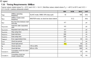

BQ40Z50: SMBus criteria on the clock high period
Part Number: BQ40Z50
hi Team,
customer using bq40z50 with their system.
per system testing, it's found that the SMBus communication Thigh (clock high period) can be 3.905us
this is lower than bq40z50 spec on SMBus Timing requirement min of 4us
while, also checking the system on the shorter time observed, can we also check with the design team's comment on if the 3.905us can be acceptable or any side effects?
