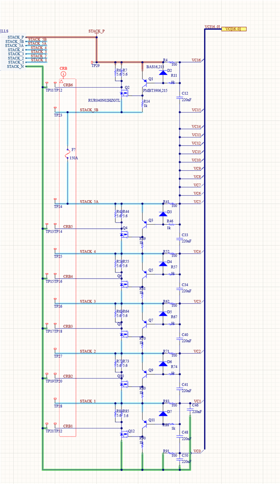

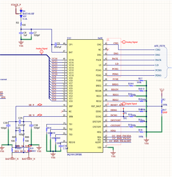

We have the BQ76952 on a few of our 6S battery packs. The intent is to run semi-autonomous, but in the short term to get samples out the door I will let them operate fully autonomously. I have a few issues that I need help with, but didn't want to collect the wrong data so please let me know what I need to get you for each question to get it resolved. I have NOT used the software, nor do I have any way to use the software with my IC in circuit.
A bit about our board:
  • Most of our circuit (as you'll see below) is derived from the BQ76952 eval...which we didn't have time to actually test
  • We aren't utilizing any analog temperature inputs
  • Cell balancing is done with external nmos and pnp transistors...I believe this was pulled from another TI reference.
  • I2C from host MCU
  • Not using the fuse drive. We implemented an inline fuse between cells 5 and 6 due to physical constraints.
  • Not using the AFE internal voltage regulators
  • I have many board components powered from STACK_P
(RST_SHUT correction...R2 DNP, R47 100k)

When the mcu comes online it resets the AFE by holding RST_SHUTDOWN high for ~1 second. Then it waits a few seconds before starting by polling alarm raw status to check for FULLSCAN on a two second interval.
Once complete I enter config mode, and load in values. I haven't used that software tool so my settings aren't compiled succinctly but here is what I have:
  • Vcell mode: 0x801F (cells 1-5, and top cell 16...total 6 cells)
  • CC gain: 0x41EF41F2 (cs resistor is 0.25 milliohm)
  • Capacity gain: 0x4B081C6A
  • Enabled protections A: COV, SCD, CUV, OCC
  • DSG current threshold: 5000 mA
  • CHG current threshold: 5000 mA
  • Balancing
    • configuration register: CB_RLX
    • all temperatures left untouched
    • interval untouched
    • max cells left a 1 (though I did try 2 as well)
    • min cell v dsg: 2180 mv
    • delta relax: 15mv
    • stop delta relax: 5mV
  • CUV threshold: 42 (2.125V)
  • CUV delay: 28
  • CUV hysteresis: 1 (I see now it's supposed to be 2, but I would hope the AFE checks this? I'll update them now and see if anything changes)
  • COV threshold: 52 (2.631V)
  • COV delay: 28
  • COV hysteresis: 1 (I see now it's supposed to be 2, but I would hope the AFE checks this? I'll update them now and see if anything changes)
  • OCC threshold: 12
  • OCC delay: 1
  • SCD threshold: 2
  • SCD delay: 1
  • DCHG and pin config: 0x40
  • ALERT pin config: 0x82
  • CFETOFF and DFETOFF pin config: 0x02
  • DA config: 0x19 (mV, and I set this to use the internal temperature sensor because I thought maybe it was preventing balancing from not having a source)
  • power config: 0x39C0
  • FET_EN done here...should it be within or outside config?
  • exit config mode
Wait 4 seconds. Then start polling data.

  1. I'm not measuring any balancing happening. I am checking CB_ACTIVE_CELLS and it does tell me cell 16 is balancing, but I'm not seeing anything on the board. And none of the cbstatus registers are incrementing. Our analog power engineer has not yet diagnosed the transistor network to see what is going on.
    1. Is there a maximum difference where balancing wont occur? I have two cells drastically out of balance I want balancing to bring up

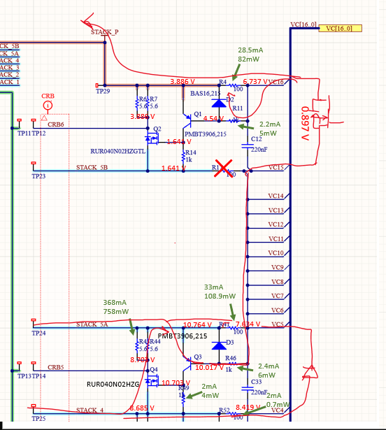

  3. With the fuse removed from our circuit, we still have a current path on the board. It seems like voltage is being drawn out of cell 4 and 5 to feed STACK_P and power the board.
    1. I have voltage measurements across all balancing components, again our analog  engineer hasn't reviewed yet.
    2. Could you tell me if you see anything obvious, and anything I need to know about the power fets within the AFE that could be allowing enough current to flow through enough to power on the PNP at cell 4?
Please let me know what data, and in what format you would like to see to assist. Or if anything you see already stands out as obvious.

    1. To see the balancing waveform, you may need to connect a scope at the VCx pins near the IC. It looks like the test points are on the other side of the filter components. If COV or CUV Alerts occur, the balancing will stop immediately, so that may be what you are seeing. There is not a maximum value where balancing won't occur.

    3. There is nothing unique about the cell 4 input. It appears there must be a current path on the hardware. The first step would be to track down where that current is flowing. Maybe replace the IC if it is possibly damaged.
    As far as further data, a BQStudio log file is always helpful. I don't know if you have an EVM handy, but you could remove the I2C jumpers and connect the EVM MCU directly to your board to log data. The cell balancing circuit you are using is not something I have seen before (using BJTs to enable FETs), so I do not have a good reference to compare to.

    3. We had the fuse off during assembly and ended up with every pack having cell 4 and 5 drained through this current path, so I don't expect IC damage. That last image I posted shows the voltages with the fuse removed, and my 3.3V regulator on the board drawing current up and out through VC16-stack_p. So it looks like there's a good chance the balancing transistors have something going on there.
