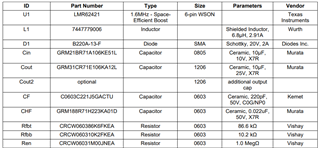

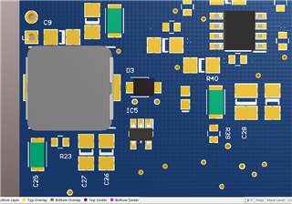

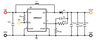

    It might be possible that the regulator is oscillating. All decoupling capacitor are soldered close to Vin pin, the tracks lengths are less than 5.5mm. Please find below a screen shot of the layout and schematic.

    Typically, we don't need this resistor for other boost chips. But LMR62421 is relatively old chip, I don't exactly know whether it has some specific requirement for EN input. If there is no problem adding the resistor and there is layouts space on PCB for it, could you add it on PCB?
    Could you please use multimeter diode gear to test the ESD diode of the chip's pins to check which pin is damaged? And could you please measure waveforms of Vin, EN, SW and Vout to check?
    The current application is similar to EVM design, you can refer to user guide sch for reference. For layout, SW-D1-Cout -GND is the most important loop which should be short. C28 is very far from IC in current layout. please place one small package and value capacitor close to the chip.
    I think the sch and layout can be improved. But since layout is difficult to change, if adding the EN resistor can solve the problem, I think it is the easiest method.
