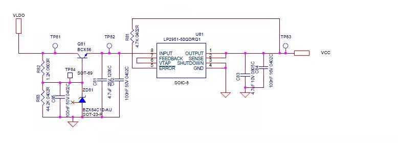

The start up output waveform and schematic are as below, the spike is up to 6V, the capacitors are all ceramic but we have tried adding 1Ohm resistors, and disconnected the load, the waveform are same, could you please give me some comments? Thanks.

    Have you attempted increasing your output capacitance? - Please reference section 8.2.2.1 in the datasheet.

    Also, for the Error pin:
    The output of the comparator is rated to sink up to 400 μA. A suitable range of values for the pullup resistor is from 100 kΩ to 1 MΩ - reference Figure 34 in the datasheet.
    This may be acting like a load.

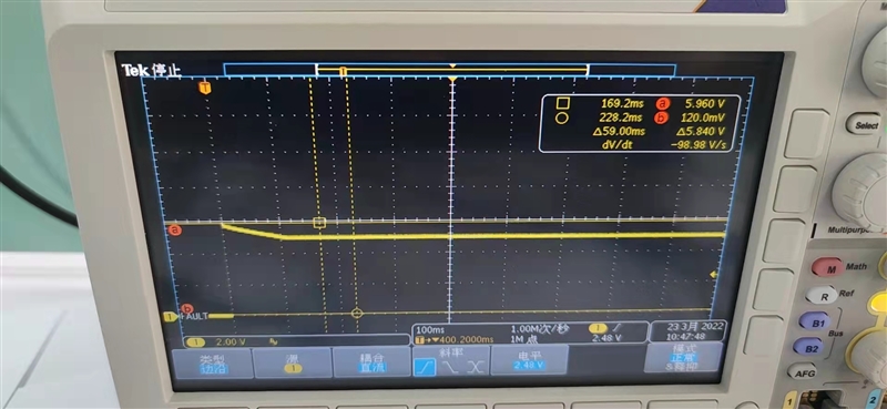

    Below is the voltage waveform of TP82.
    The LDO is a CAN transceiver, they disconnected the load test measured the waveform, same overshoot.

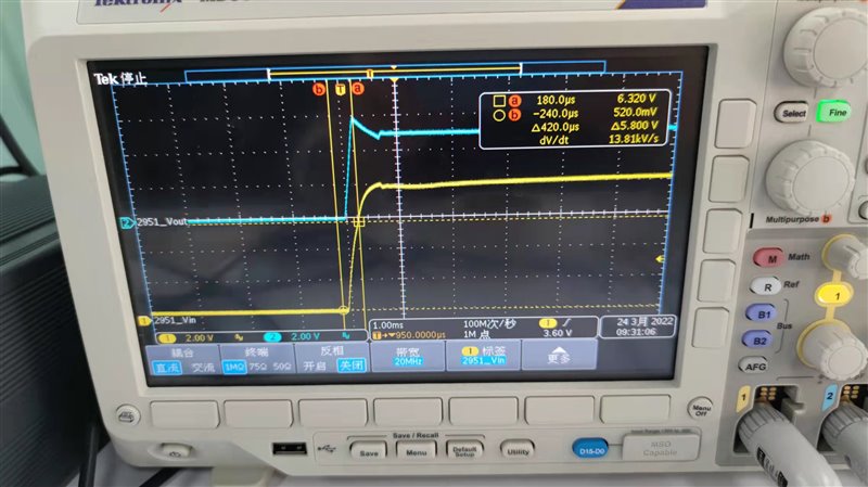

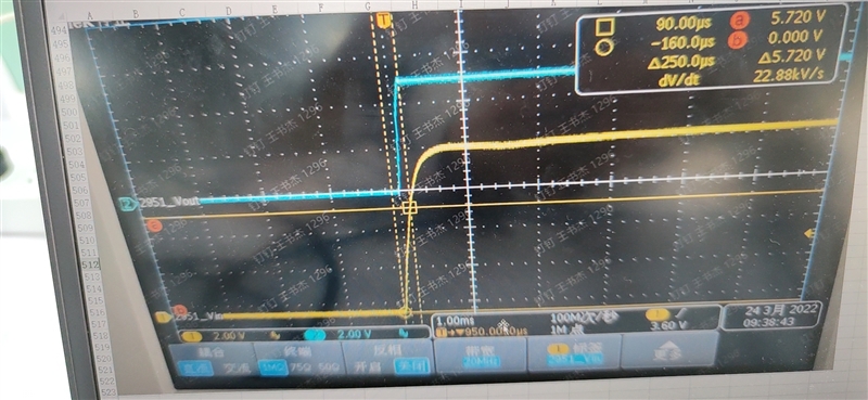

    Below the first picture is 4.7uF output cap, blue curve is output and yellow is input.
    The second picture is 2.2uF output cap, so strange that the overshoot disappears, could you please explain why? Thanks.

    the error amplifier has a slower transient response which can cause the output to overshoot significantly when the device is recovering from a dropout condition. Faster ramp rates result in more overshoot and may require a zener diode on the output to limit the VOUT overshoot.
    Looking at the Input of the device, it seems like the device may be entering dropout. To test this - please increase the speed of the start-up ramp rate.
