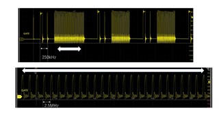

I am designing a flyback boost circuit.
A resistor is connected to the RT pin and the switching frequency is set to about 250 kHz.
However, early in the operation, there is a period of time when the GATE pin oscillates at about 2.2 MHz.
After about 100ms, the oscillation returns to 250kHz as set and the voltage is boosted to the set voltage.
How can this 2.2MHz operation period be eliminated?
We have confirmed that the behavior of the SS and UVLO pins is the problem.
Sorry, I cannot show you the circuit diagram.

  • Hi Stefan, thanks for your reply.
    I'm sorry. There was an error in the text.
    I wanted to tell you that  We have confirmed that there is "no" problem with the behavior of SS and UVLO.
    We cannot show the full schematic, but we can show the circuits around the device.
    The waveforms are described below.
    In the early phase of the boost, there are periods when it operates at 250 kHz as set, and other periods when it operates at 2.5 MHz.
    I would like to know what causes this behavior.
    Katsuya
  • Hi Katsuya,
    currently I have no explanation for what can be the issue on that, because i have never seen this before.
    To further investigate on this it would be good to also see the signal on the RT pin during this conditon.
    It would be also good to check the layout if there is anything which can interfere into the RT input or into the Analog Ground.
     Stefan
