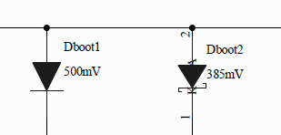

    added series 0 Ohm Resistor into the Gate line of the FET is also a good practice so that it is easy to add a resistor in case it is required.
    Is there a reason why Dboot1 and Dbout2 are different?
     Stefan

    I used TI's WEb Bench Designer, online tool. I put all the design requirements like VIN VOUt, IOT etc and I got the design. I have attached here the schematics I received from WEbbench tool. It is designed for 11A IOUT.Dboot1 and Dbout2 are not different , they are same part PMEG6010CEH.
  • HI Zhonghui,
    for the Diode i got fooled by this in the schematic:
    While reviewing the information in this thread i have seen that there are two different schematics:
    - in 1. entry attached.
    - in zip file as pdf
    - in zip file as altium file
    Can you please clarify which one is the actual/correct one.
    I am just working with the Webench team is I think there is an issue with the model not properly considering all modes.
    Please use the Design Caluculator from the product page: LM5176-Q1 data sheet, product information and support | TI.com
    in the mean time.
     Stefan
