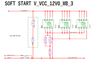

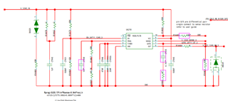

Hi team
customer is evaluating our TPS24711DGSR, they set the current limit threshold at 75A, but the have the short time high current case.
They have below high current occasions after the start up finished
92.99A  (last for 200us)
76.59A  (last for 1ms)
so my question is: is there any risk to trigger the OC protection for these two cases?
And is there any blank time mechanism for this socket? easpecially when the start up have finished.
