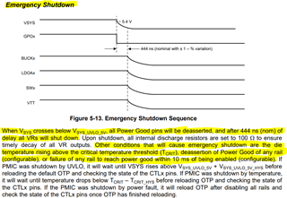

  • Hi Teik,
    It seems like the PMIC is executing an emergency shutdown. The main supplies VSYS, V5ANA, PVINx which comes from external regulators are shutting down before the CTLx pins go low.
    If the external supplies are removed from the PMIC, then the PMIC will not have power to execute a sequenced power down.
    Brenda

  • Hi Teik,
    A power down sequence and an emergency shutdown are executed under different conditions. The power down sequence, just like the power-up, can be controlled with the CTLx pins, the power good of a previous rail and delays. This can be done while the external supplies VSYS, V5ANA and PVINx are connected. On the other hand, the Emergency Shutdown will be executed when VSYS crosses below the UVLO threshold. Other conditions that will cause an emergency shutdown are described in the image below (from datasheet). The reason why you are seeing some of the CTLx pins going low after the rails are shutdown is because there are two VSYS UVLO thresholds; one is called  VSYS_UVLO_5V and the other VSYS_UVLO_3V.
    • UVLO Thresholds
    • EMERGENCY SHUTDOWN
    • POWER DOWN SEQUENCE CONTROL
