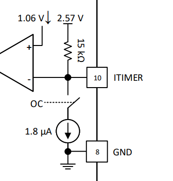

Hello Team,
have a question about the TPS25946 ITIMER. Could you help me to answer the following questions?
1. Is there a limitation on the capacitance values connected to the ITIMER terminal? How much time limitation for t_ITIMER?
2. If ITIMER uses a large capacitance and the transient over load current pulse interval time is narrow, it is expected that the CITIMER will not be able to charge sufficiently. Does the blanking time decrease if the next transient load current pulse exceeds the current limit before the Citimer is charged?
