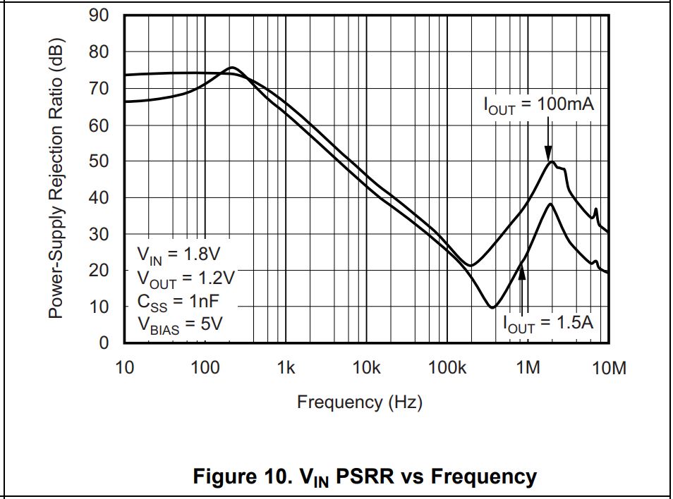

1. I saw typical value show in the DS as below, could you help to know the Min & Max value as well? because customer would to verify PSRR on their board and make sure the test result is pass our criterial.

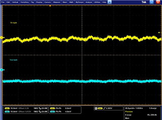

    Customer try to calculate PSRR as below, could you help to check the result is meet TPS74801 spec or not?
    Vin= 3.3V
    Vout= 1.8V
    Iout= 0.04A
    Customer measure the PSRR and VAC = 1V (p-p) at 1kHz, then get below result.
    Ripple(input) = 8.8 mV
    Ripple(output) = 4.8 mV
    PSRR = 20 log10(Ripple(input)/ Ripple(output)) = 20 log10(0.0088/0.0048) = 5.264dB
    Can you please help judgment does the result of PSRR is meet TI TPS74801 design?
     And do you have PSRR test report can share with customer?
    Mark
  • Hey Mark,
    Does the scope have an fft function? If so please send the Ripple (input) and Ripple (output) fft scope shots.

  • extra two questions need you help to check:
    1. customer to add 1V peak to peak AC signal to the input, but only 8.8mV measured show in the scope, do you know why? I saw the document use THS3120 for measurement, does it means we need to tool for PSRR testing? do you have other recommend method to to measure PSRR when customer without THS3120?
    2. if the 1V peak to peak AC signal exist on input side, according to the formula the PSRR = 20log(1V/4.8mV)= 46db, looks it is not align with 60db showed in datasheet. do you have any comments?

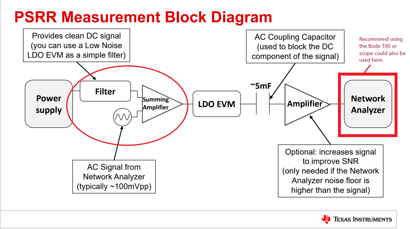

    1) For PSRR you need to do small signal analysis like 100mV max. The THS3120 it is a high speed amplifier used to help gain up the signal, if you were not using this then the measurement can not test PSRR this way using a scope. It would be challenging to see the small signal differences here.
    2) 1V is not small signal analysis, hence this was not a valid PSRR test.
    3) Do you have a Bode 100 that you can use? That would be the preferred method.

    There needs to be some sort of amplifier to gain up the signal if you are using a scope to get an accurate measurement. Yes, it says to 1V because they used an amplifier to gain up the signal.
    This pdf and diagram should help the customer, there needs to be a summing amplifier, filter before the LDO, and then an amplifier into a network PSRR Measurement.
    Hope this helps!

    I am not sure what kind of answer the customer is looking for, because PSRR changes based on different the variables and at different frequencies, it's not a PASS or FAIL test. It's a graph that we characterize based on a sample of units for a typical metrics and is not something that is tested at final test. The caps the customer used are different then the test conditions defined in the datasheet (see below).

    Are you wondering how to get the PSRR curve to be a closer match to the one found in the datasheet? The same output capacitance would help. If you notice where the knee of the graph is and where the bend turns it is similar to one found in the datasheet. Looking at the knee (or where the graph turns) to compare two different PSRR graphs is a good way to see similarities and verify between two different parts are functioning the same if capacitances different. With different capacitances the higher frequencies are going to differ more with lower frequencies are going to be more similar.
