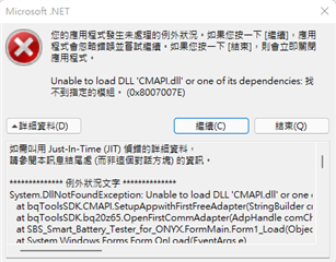

Hello Sir:
Do you have updated version of bqToolsSDKb20180726-1.0.2?
We need to work in Win11.
Would you please help to provide upgrade version for us?
Thanks a lot.
  • Hello Statham,
    All existing applications are expected to work on Windows 11. Let me know if you run into any issues.
  • Hi Shirish:
    Please refer the screen shot and txt files.
    Any recommendations please let me know.
    Thanks a lot.
    ************** 例外狀況文字 **************
    System.DllNotFoundException: Unable to load DLL 'CMAPI.dll' or one of its dependencies: 找不到指定的模組。 (0x8007007E)
       at bqToolsSDK.CMAPI.SetupAppwithFirstFreeAdapter(StringBuilder cmdPipeName, StringBuilder dataPipeName, StringBuilder priorityPipeName, StringBuilder evDeviceName, String exePathwithArgs, Int32 buffersize, Int32 processCreateStyle)
       at bqToolsSDK.bq20z65.OpenFirstCommAdapter(AdpHandle comChannel) in D:\OneDrive\Source\SBS_Smart_Battery_Tester_for_ONYX\SBS_Smart_Battery_Tester_for_ONYX\bq20z65.cs:line 177
       at SBS_Smart_Battery_Tester_for_ONYX.FormMain.Form1_Load(Object sender, EventArgs e) in D:\OneDrive\Source\SBS_Smart_Battery_Tester_for_ONYX\SBS_Smart_Battery_Tester_for_ONYX\FormMain.cs:line 67
       at System.Windows.Forms.Form.OnLoad(EventArgs e)
       at System.Windows.Forms.Form.OnCreateControl()
       at System.Windows.Forms.Control.CreateControl(Boolean fIgnoreVisible)
       at System.Windows.Forms.Control.CreateControl()
       at System.Windows.Forms.Control.WmShowWindow(Message& m)
       at System.Windows.Forms.Control.WndProc(Message& m)
       at System.Windows.Forms.ScrollableControl.WndProc(Message& m)
       at System.Windows.Forms.ContainerControl.WndProc(Message& m)
       at System.Windows.Forms.Form.WmShowWindow(Message& m)
       at System.Windows.Forms.Form.WndProc(Message& m)
       at System.Windows.Forms.Control.ControlNativeWindow.OnMessage(Message& m)
       at System.Windows.Forms.Control.ControlNativeWindow.WndProc(Message& m)
       at System.Windows.Forms.NativeWindow.Callback(IntPtr hWnd, WM msg, IntPtr wparam, IntPtr lparam)
    ************** 已載入的組件 **************

  • Hello Statham,
    Does bqStudio also give the same error? It also uses similar components.
