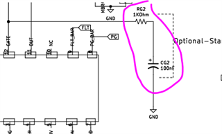

  • Hi Calvin,
    The design looks fine. The RG2 slows down the discharge of CG2 and then affects the turn-off response of the FET.
    Please reduce the RG2 to 22Ohm and check the behavior. Also, for your design CG2 can be reduced to 10nF.
    Please share the test results of GATE, Timer, FLT, input current for understanding.
    Rakesh
  • Okay I will test it with the new value and test again.
    May I know in the future how to calculate the correct RG and CG for other design?
    Because the RG CG is fixed value in the calculator, we thought it is already designed for any kind of application.
    Thank you!

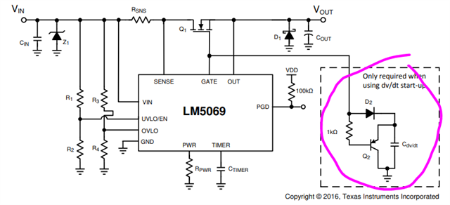

  • Hi Calvin,
    For CG values in the range <5nF, RG of 1kOhm should not be a problem. For large CG values upto 47nF, we should reduce 1k to 22 Ohm to discharge CG fast. Sorry for not being clear in design calculator.
    Beyond 47nF, we suggest to use a local pnp discharge circuit as shown below. This helps to reduce the stress on the GATE as the discharge is local
    Rakesh
