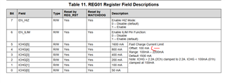

I think I found a bug in the Battery Management Studio Register Setup.
REG01 -> Charger Current Limit Register  has an Offset from 100mA. If I understand right from the other part of the Datasheet this offset value will be extract from the of the setup current.
Thats mean if I want to have 150mA then the setup settings 150mA - 100mA = 50mA -> only bit 0 need to be set to 1.
Battery Management Studio set the last two bits. 50mA and 100mA too.
Please give me a feed back, it is a Problem in the datasheet or in the B.M.S. Program?

  • Hi Charles,
    Thank you for your informaiton, but i'm a bit confused.
    The same text stay at Reg00 Battery Voltage. This register is a good example:
    If you check the image below, as you can see the max value is 9.2V. With all of the Register, it is possible to setup up to 2.55V. So we can not setup the 9.2V. If we want to set up the voltage we need to use the offset -> 9.2V - 6.8V = 2.4V -> This value can be set with the register.
    In the document is the same text at Reg01 as you can see below. My opinion is still that either the document has a bug or the program.
    Please check one more time, and give me some answer.
    We have some problem with the charging current, this is the reason why a want to know this.
    Botond

  • Hi Charles,
    yes the 9.2V in Reg00 is clear for me. In this register you subtract the offset from the voltage value (9.2V - 6.8V = 2.4V -> 11110000). (In Reg02 you need to do the same with VINDPM to set it up right! 4.3V - 3.9V = 400mV Reg xxx00100)
    It is not clear why you don't need to do the same at REG01 -> in this register was defined also an offset 100mA
    Botond
  • Hi Botond,
    I understand your point now. For an example of the charge current, I set 900mA in BQStudio, which using the 100mA offset should give 900mA-100mA = 800mA -> 010000 but BQStudio is giving me 010010. I will follow up on this with my team to figure this out.
    In the meantime, if you could send me the value of the registers on your device, I can look into why your charge current is not as expected, and see if it is an issue unrelated to the offset.
    Regards.
    Charles

  • Hi Botond,
    Selecting the 150mA fast charge current in BQStudio will get you the charge current you want.  I just verified this on an EVM we have.  The binary value of the charge current in the REG01 will not incorporate the offset, but you still get 150mA.
    Charles
