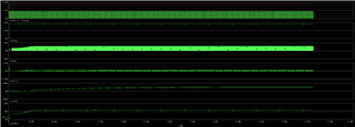

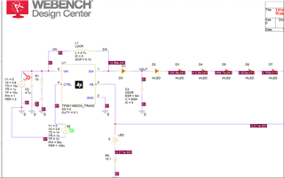

  • Hi Mason,
    I took a while to provide a full simulations to illustrate the problem. I was using the testbench I downloaded from Spice for TI:
    And I obtained the following:
    1) Just setting DUTY = 1 without changing the circuitry:
    2) I now set the D=0.9. From this value and bellow, there is no coherent result, and the signals look broken:
    3) I changed to 0.5 without significant difference in aspect:
    4) Just to demostrate that the model might not be correct, I simulated without any signal to the CTRL port and DUTY=1 (It should not provide any signal at all but it was working as if it has a DC signal, or 100% Duty cycle PMW):
    5) Finally, I connected an actual PMW source with 90% duty cycle and DUTY=0.9 on the LED driver. No change is observed:
    As it seems, the Spice model seems to not be working properly.

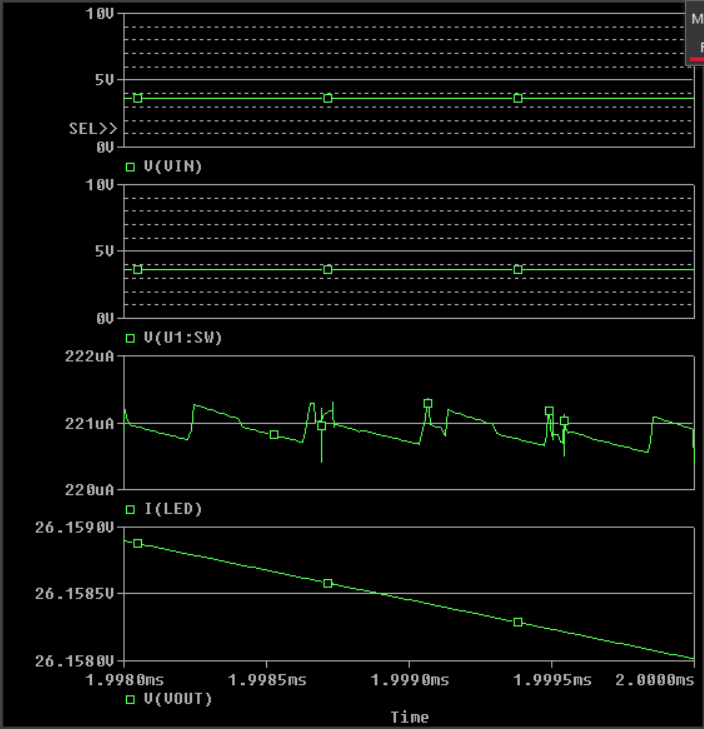

  • hi Francisco
       I have tried the simulation model and it can work after some modifications. I added a PWM pulse source at CTRL pin, the frequency is 10kHz, 50% duty cycle. Please ignore the DUTY set in the device, I do not think it works after trying different DUTY values. The LED current is scaled down according to duty cycle.

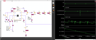

  • Hi Mason
    I repeated your circuit exactly as you did and I got the same results as you. However I tried to build the circuit from the Steady State circuit, and basically every movement I do on that circuit, it brakes the IC function.
    I could have my circuit running by replacing carefully piece by piece and finally I could simulate the desired situation. However, the IC is not working stand alone since I tried to also build the circuit from blank and is not working well (again the same odd value).

  • hi Francisco
       Please see the result. I can simulate you condition correctly with following condition:
    Vin=3,6V, LED 4 in series, PWM 1.8V, 100kHz, 50%duty cycle.
  • Hi Mason
    I replicated the circuit but I am still having the odd result when I do it on a separate project. But I have a final question: How do I get access to the WLED and the LSCR and CESR components? I tried to find them on the library but I was not able and I had to copy them from the Test setting.

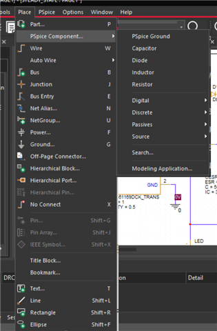

  • hi Francisco
        You can add any components you want as below, diode, inductor or capacitor. The values can be set based on your requirement.
  • Hi Mason.
    However when I use those devices are actually ideal devices. I  cannot find where to edit ESR or anything else. When I checked the Pspice models for those components, they are part of the TPS61169. The components you said are default components.
    How can I get access to those components that are listed on the TPS61169 library?
