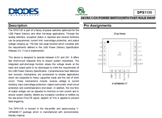

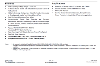

Hi team,
Do we have solution could compete DIodes DPS1135?
below is the information of DPS1135.
