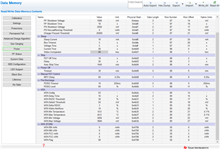

Hi all,
We want to test Unintended Wakeup but we can't find these settings in BQStudio :
Power/Unintended Wakeup/Delay
Power/Unintended Wakeup/Count
You can see on the attached screenshot
Loïc
  • Hello Loic,
    It looks like this register may have been kept private in the bqz even though it was defined in the TRM. I attached a BQZ that should allow you to adjust the delay.
