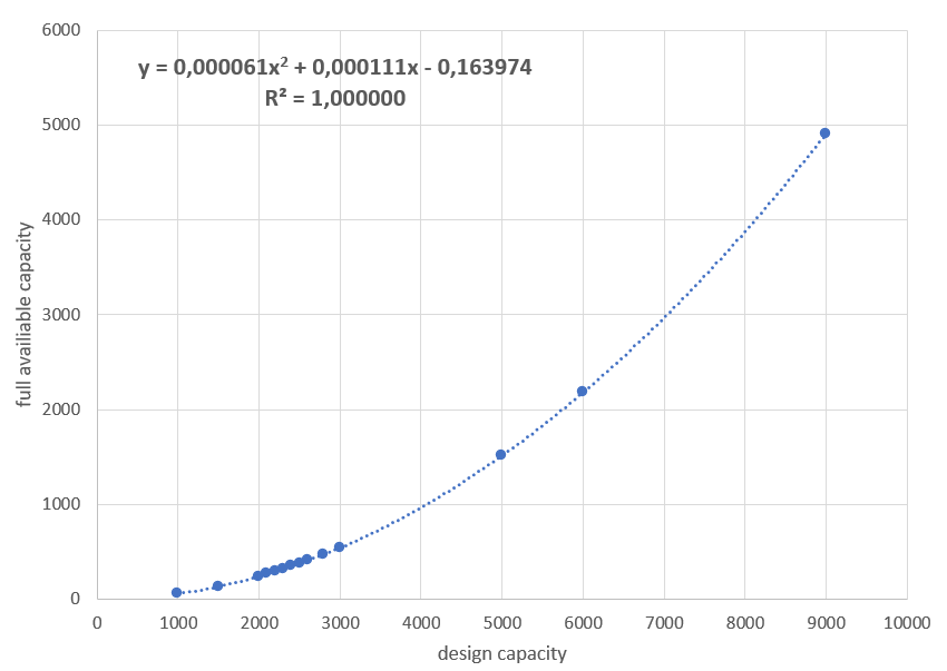

So I decided to test diffrent Design Capacity values. Here is what I get:
design capacity full availiable capacity
1000 61
1500 136
2000 242
2100 267
2200 292
2300 321
2400 350
2500 378
2600 409
2800 476
3000 545
5000 1514
6000 2181
9000 4906
Is this correct behaviour or something is wrong?

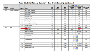

  • Hello Krystian,
    I think the error here is due to units. Reference this section of the TRM:
    I checked your numbers you provided against the formula and they seem to match exactly what I would predict. You would have set up a scaling factor for writing QMAX to accomplish this. Or, just don't write anything to this value (QMAX). Simply sweeping design capacity should work because the gauge will multiply that value by 1 to determine the QMAX. In general, you shouldn't write to QMAX because the gauge will update it by itself. Let me know if making this change works for you, or if you would like more explanation.

  • Hello Krystian,
    Thanks for providing these. I see what you mean by the SOC now. It appears the gauge has calculated an extremely small FCC like you mentioned earlier and thus the SOC changes rapidly. When I look in your configuration. I see a dash on QMAX CELL 0, I believe that means default? It should be 16384 then, but maybe it is still stuck at some lower value from earlier? Can you try writing 16384 to QMAX CELL 0 in a similar manner to how you did it initially to see if that helps?
    If we see the FCC change to be close to 2200mAH that will be good. But even if we see FCC go to some other value, then we know at least that the QMAX CELL 0 is playing a role in this somehow. And if it doesn't change at all, we can investigate why that is happening. Hopefully this will reveal the issue. Another thing to consider, is doing a full reset of the gauge, but it may not be necessary yet.
