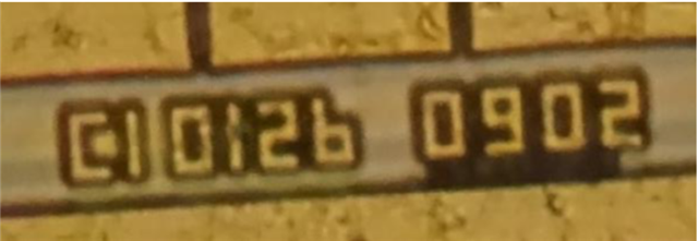

TPS7A2450DBVR, our lab ran a test on this part and called the die inconclusive. No TI logo is seen.
Hi Jessica,
I had one of our layout engineers take a look at the image you shared and compared it to the layout design file for this part and he said the die image you shared is totally different than the layout for TPS7A24.
Can you please share the packaging label information and where you purchased these parts from? I think this should be sent to our fraud investigation team.

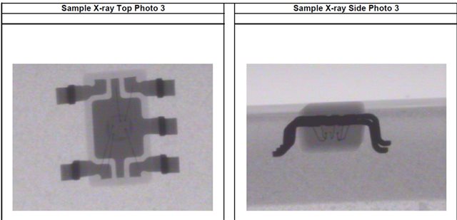

The packaging label is not available to me as this part is assigned. What I have is they passed electrical test, I have a X-ray photo for you too.
The analysis process is a 4 step guide, Inspection, Xray, Delid and Test, in the Delid/Decap test the part is classified as "inconclusive".
