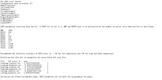

    When I use Fixed EDV, EDV0 can be set according to the shutdown voltage of the whole machine. Are EDV1 & EDV2 calculated using GPC CEDV tool?
    Is it the same with Compensated EDV?
    Because I need to fill in the parameter value in DF,But the report returned by the GPC CEDV tool does not have these parameter values (EDV1&EDV2)

    When using the compensated EDV points, the EDV voltages calculated will be based on the EMF CEDV parameter. If you are not using the fixed values they do not need to be populated. If you are using the fixed values you would not need to submit any data to the GPCCEDV tool.

    The EDV0 point should be found from the GPCCEDV calculator, it is essentially the terminate voltage where SOC = 0% like you mentioned.
