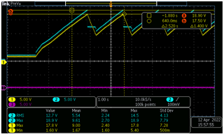

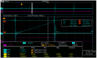

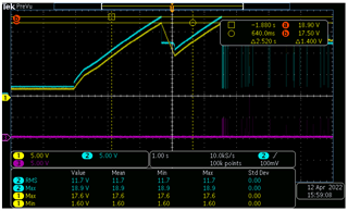

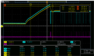

My unit startup with <150Vac is properly and after startup, and then startup the PFC, also function well.
Lm:120uH
But if i use high input voltage such as 150Vac, my unit can't startup properly and I can see the CS was hit 0.6V (on duty is suddenly go from <3us to >5us)
If I use 180Vac or above, there will have no any switching. I don't know why the RUN is not enable when using High input line
Attached waveform with below setting (90Vac, 120Vac,  180Vac)
90VAC
120Vac
180VAC
Channel 1 Yellow Pin VCC
Channel 2 Blue Pin SWS
Channel 3 Pink PWML
For the one 150Vac
Channel 2 Blue Pin -CS
Channel 3 Pink PWML
Would you please advise what signal or parameter that I can adjust to resolve it?
