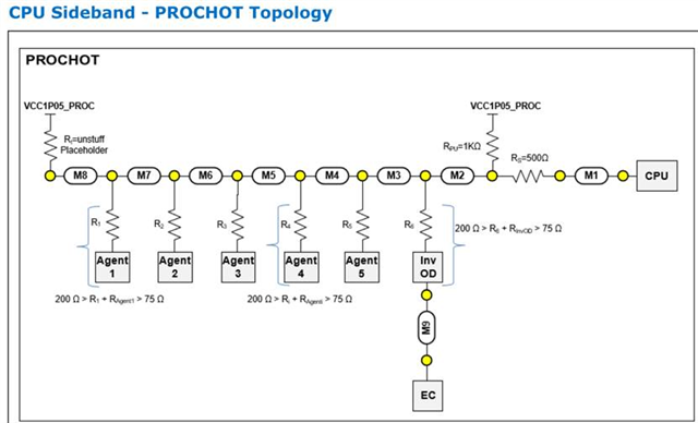

What is the internal resistance at #PROCHOT pin?
Hardy
Hello, Tiger
In this case, I connect #PROCHOT pin directly to the CPU only through one resistor. No other connection whatsoever.
should I use 60ohn or 0ohm?
I'm confused because our #PROCHOT is pulled up by 50ohm, I couldn`t know the impendance of it.
