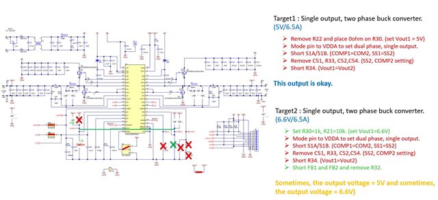

Hi Team,
I modified the EVM and met some problem. Please see below image.
Sometimes, output =5V when I set Vout = 6.6V and I tried to re-power up the system and the Vout can be 6.6V.
Roy
Hi Team,
Roy
Hi Tim,
Thank you for your comments. The issue can be fixed. In addition, can you share why feedback resistor needs to > 5kohm? Thank you.
Roy
Hi Roy,
It's mentioned in the datasheet. If the effective resistance at FB is less than 5k, then it will be detected as a fixed 5V output (this is checked at startup where FB low or high designates fixed 5V or 3.3V, respectively).
Tim
