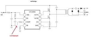

  • Thanks Teng, there are further questions here.
    Question 1:
    - FB pin is connected to GND via a resistor. But how to configure the COMP pin?
    - Is below diagram half-bridge configuration ok? There is no N (Nature) point of the half-Bridge, correct?
    Question 2:

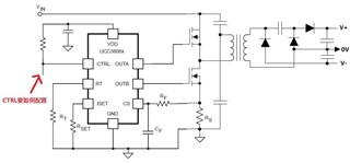

    - Does UCC28082/3/4/5 work with open loop?
    - How to configure the CTRL pin?
  • Hi Brian,
    To Q1:
    If FB connects to ground, COMP pin will be high, we can leave COMP pin floating. Shorting COMP pin to ground will disable PWM.
    The provided half-bridge circuit is not right, if used for half-bridge control, an isolated driver is required to drive high side FET.
    To Q2:
    Yes,  UCC28082/3/4/5 can work with open loop.
    Connecting CTRL pin to VDD by a resistor R1,  if  (VDD/(R1+140k))*60k - 0.3V > CS_Voltage,  it will output maximum duty,
    decrease R1, will decrease PWM duty.

  • One more thing to confirming with you.
    Are UCC2808A and UCC28082/3/4/5 able to be implemented for half-bridge topology? Or it just can be for Push-pull topology?
    Brian W
  • Hi Brain,
    It can be used for half-bridge, but an isolated driver is required for low side FET and high side FET.
    Teng
