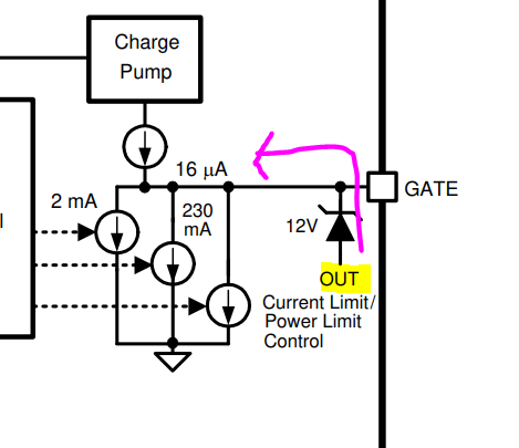

  • Hi Paul,
    Thanks for the details.
    From the failure description, it seems that there is leakage at the GATE node which can be due to partial failure of the pull-down sections or the ESD structure at the GATE. If we are controlling LM5069 using UVLO pin, then every time the Cout discharges through the GATE pull-down section which can stress the part.
    Since the parts failed during power cycling test. Can you share the start-up, turn-off with UVLO=LOW waveforms to understand more. Please probe Vout, GATE and UVLO pin voltages.

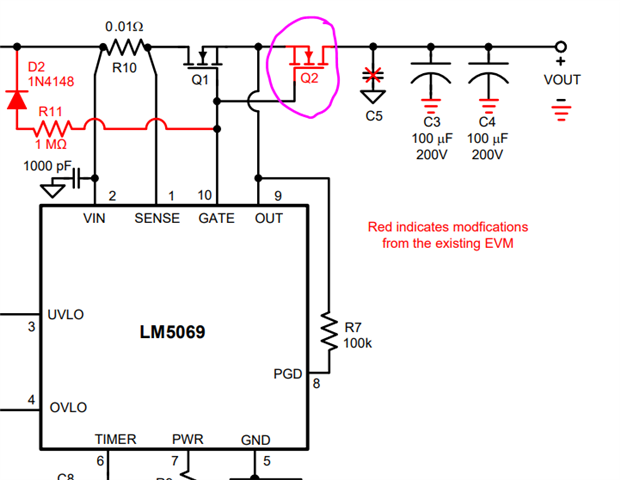

  • Hi Paul,
    Thanks for the test results. It gives us clue now that why GATE is getting stressed during power cycling. If such frequent power cyclings are expected in actual use case, please use blocking FET in series as shown below.
    https://www.ti.com/lit/an/snva683/snva683.pdf
    Rakesh
  • Hi Rakesh. Thanks for that. We're so advanced in our deployment of this solution that it's not possible to apply this retrospectively to our PCB design at this stage so we're looking at adding a series diode in the supply line to prevent the majority of the capacitance feeding back into the driver.
    See the presentation here
    Diode comparison.pdf
    We can use the diode to block 1mF of the 1.3mF capacitive load which will limit the duration that the LM5069 has to dissipate power through the GATE clamp.
    What do you believe would be an acceptable level of capacitance/energy dissipation in the device where we would not expect any damage to occur? There has to be some expectation of this happening as I don't think our use case is completely outside of what would be expected (though the capacitive load is high).

  • Hi Paul,
    Our design team still feels that it is too much stress for the internal pull-down to handle if power cycle happens frequently. The pull-down FETs are sized to handle 10's of mA current but for very short interval <50ms
    I see less concern for input power recycling as Cout also discharge through the body diode of hot-swap to input side but in case of EN/UVLO cycling, the Cout will gets discharged only through internal pull-down of LM5069.
    Best regards
    Rakesh
