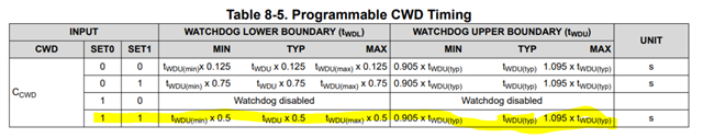

Hi team,
In datasheet table 8-4, there is a note as below.
(1) Minimum and maximum values are calculated using ideal capacitors.
Could you advise how to calculate the MIN/MAX tWDU value with capacitor tolerance takes into account?

Hi Shinji,
Thank you for your question. The process is outlined below.
Twdu(typ) = 77.4 * Ccwd * (+/-cap tolerance) + 0.055
Then when you get the boundary range for the timing, you can use that value to calculate the other boundaries of the window.

Hi Jesse-san,
In the datasheet Figure 8-4 shows the minimum and maximum tolerance calculated based on ideal capacitor, so the min and max tolerance in this figure
shows the tolerance of the device itself.
If I calculate capacitor tolerance using the equation above, how can I add the device tolerance?

Hi Shinji,
The Twdu(typ) you get from the equation get multiplied to a constant based on your SET0 and SET1 configuration.
For example: Twdu(typ) = 400ms while SET0=1 and SET1=1
so you have Twdu(typ)=400ms Twdu(min)=400ms*.905 Twdu(max)=400ms*1.095 ====>> Twdl(typ) = Twdu(typ)*.5 ==> Twdl(typ) = 400ms*.5 similarly ==>>Twdl(min)=Twdu(min)*.5 Twdl(max)=Twdu(max)*.5
You just have to repeat the process for your worst case values.
I hope this helps.
