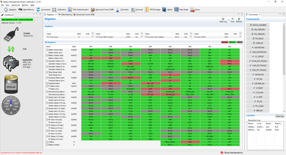

I have a battery pack where both the discharge and charge FETs are stuck open, but I don't understand why. I've tried looking at the status in bqStudio (and comparing it to a working pack), but nothing is jumping out at me as the culprit. I don't see any of the obvious protections settings having tripped. I do see that the "FUSE" bit is high, but it's unclear what this means (the manual isn't particularly illuminating). Anyone have any ideas? I included a screenshot below of the display from bqStudio.
