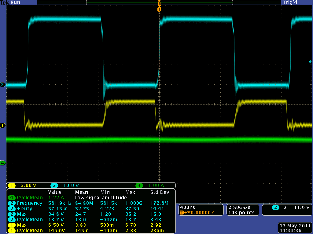

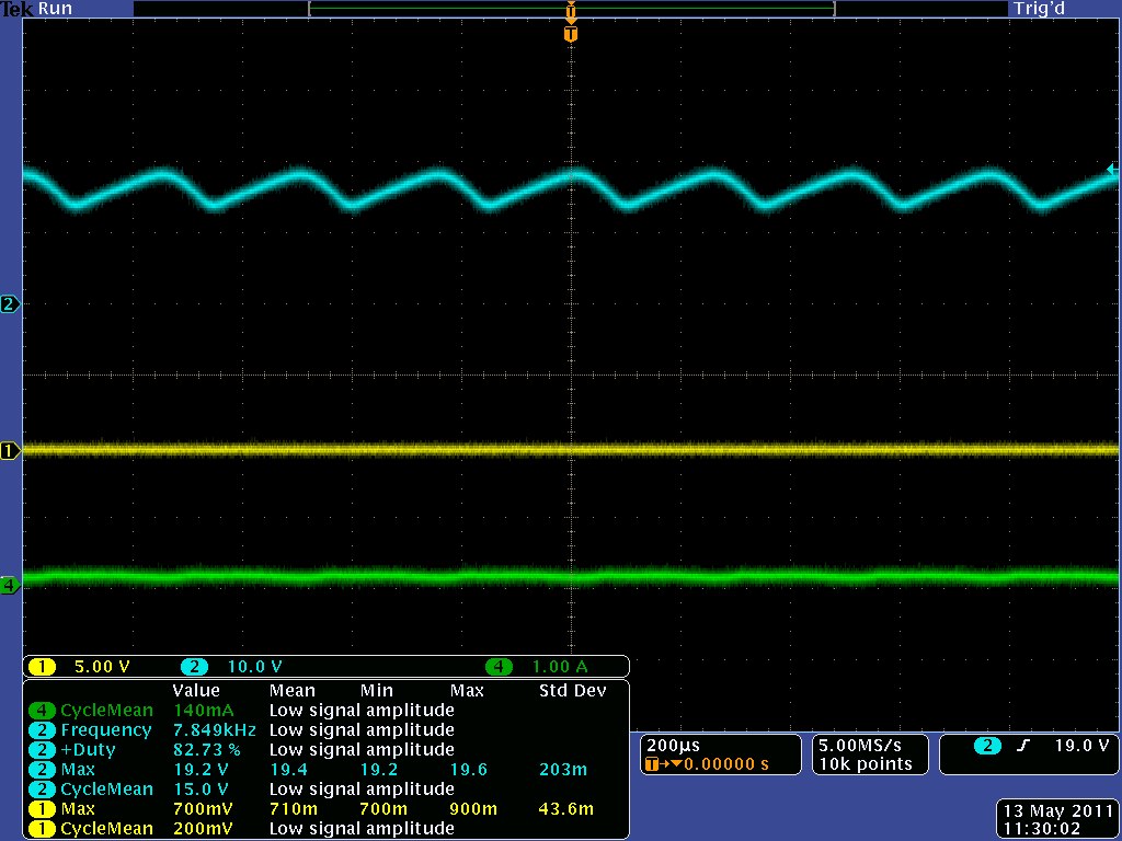

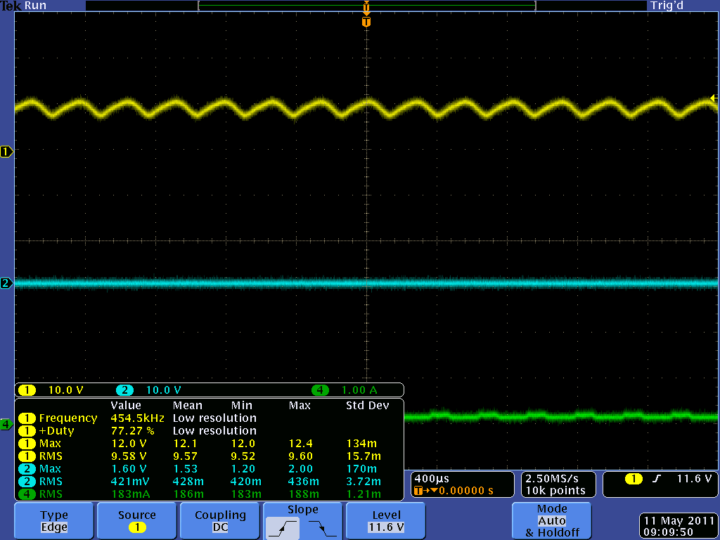

    (2) First, I produced a 20W board to charge a 12V/5AH SLA battery. When I was testing with battery no noise is there. Only when I tested with electroinc load I can hear the noise. The    scope image for output cap is attached.
    (2) Then I used the same PCB foot print for 50W board. I set MPP voltage as 27V and tried to test with electronic load. Setting of electronic load is 18V, since I am trying to charging to 18V battery. Once the charger is charging in Fast Charge Current Regulation Phase, noise is not there. But the PCB heated. Once I set the load voltage to 16V I can hear a loud noise.

  • Is the ripple voltage actually close to 2Vpkpk?
  • More than that. It is always around 4 to 6V pkpk.
  • That is a bit to high.  Are you certain that the inductor you choose is appropriate for your application?  The datasheet equations on page 21 can help size the inductor and output capacitor for your application.

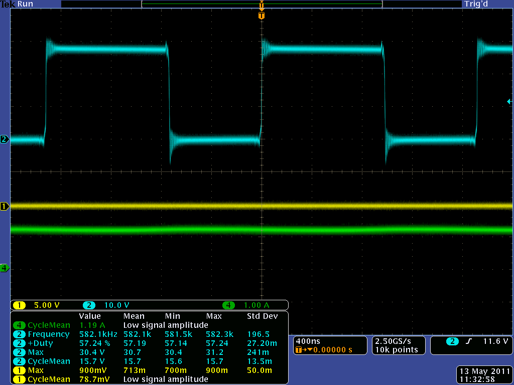

  • I just followed the suggestions in SLVA437. I want to develope a board to charge a 18V SLA battery using 27V panel (since I cannot use supply beyond 28V). Here are the modifications I made.
    (1) I changed VMPP_SET programming resistors to be compitable to 27 V input.
    (2) Changed the VFB programming resistors to be compitable to 20.25V Buck voltage for 18V battery and followed the modifications in SLVA437 so that to match the battery's thermal characteristics.
    (3) Since input voltage is 27V I changed the MOSFET to Si7960 (VDS rating 60V).
    (4) Since the charging current is programmed as 2A, I used the same output capacitor 11uF and output inductor 10uH.
    Now I assumed that Eelctronic load may the reason for the noise. Because, even with EVK I can hear a low noise. Issue is the PCB heated. Due to my requirements, please advise me how should I modify to charge a 18V battery.
    Here I attached the scope images for Vout ripple when I hear the noise, PH node voltage wave form while charging current is about 1 9A and MOSFET gate voltage waveforms while charging with the same current.
