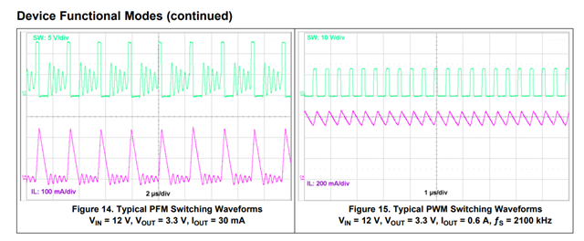

  • EMC Performance. There are 2 versions of LMR34206, one with FPWM and the other one has an auto mode for light loads. In general, which one of these 2 modes create less EMC emissions? Do you have a report with such comparison? I would like to understand if a fixed PWM signal generates more emissions or less emissions than PFM.
  • Do you have a detailed graph/table where I can see when this buck converter switches between FPWM and normal PWM and also for the auto mode version between PFM and PWM?

    Please refer to the "Device Functional Modes (continued)" graph in the datasheet. The PFM mode is going to have worse ripple current at light loads which will have higher EMC emissions. Automotive customers who are worried about EMC emissions typically used fixed frequency devices and switch at 2.1MHz.

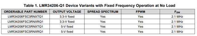

    For your second inquiry FPWM means forced pulse width modulation mode. It is a factory setting programmed into the device. Typically it is used when constant frequency operation is more important than light load efficiency. It does not "switch" between FPWM and PWM modes. This device has a couple variants that are fixed at 2.1MHz.
    I don't have detailed information for this device, but here is a good general training video on how a device switches in and out of PFM mode:
    https://training.ti.com/introduction-buck-converters-understanding-mode-transitions
