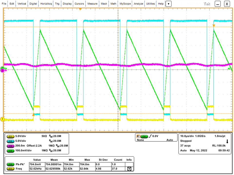

  • Hello Youhao,
    I have changed the sensing resistor from 1 mohms to 5 mohms to increase the IOUT1 resolution for the system.
    Also, prior to the change I had set my switching frequency to 160 kHz and inductor used was 33 uH.
    Rosc is 25 kohms and Rramp1 is 61.9 kohms.
    After changing the sensing resistor, I witness a decrease in switching frequency for MOSFET from 160 kHz to 53 kHz. Please find the attachment below.
    Channel 1 - High side MOSFET drain to source voltage
    Channel 2 - Low side MOSFET drain to source votlage
    Channel 3 - Input side DC current
    Channel 4 - Inductor AC current (ripple current has been increased due to decrease in the switching frequency)
    Prior the ripple current for 33 uH inductor and 1 mohms sensing resistor was less than 1 A.
    Currently after changing the sensing resistor from 1 mohm to 5 mohm, the ripple current is 3.5 A, thus system is operating in diode emulation mode.
    Why did switching frequency decrease due to change in sensing resistor?
  • Hi Jeet,
    Basically Rcs has no effects on the oscillator frequency. Please monitor SYNCOUT signal.  If the frequency is still 53kHz, then double check your OSC resistor.  It may be a wrong value or soldering problem.  Replace it with a new resistor.
    Youhao
  • Hello Youhao,
    The oscillator frequency is 158 kHz from SYNCOUT signal. But as shared the attachment above, the MOSFET are switching at 53 kHz, is there any other component/ parameter which changes the MOSFET switching frequency?
    Also, the ripple current 3.5 A shows similar results with simulation at 50 kHz switching frequency.

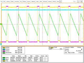

  • The above shared attachment is for an unstable output voltage. Recently, I tested the converter for a stable output voltage at 42 V with 35 V input voltage. Please find the attachment below.
    Channel 2 - Output voltage
    Channel 3 - Low side MOSFET drain to source voltage
    The ripple current is 2.5 A and the switching frequency is 79 kHz.
    Currently, the sensing current resistor is 5 mohms.
    oscillator as seen at SYNOUT is 158 kHz
  • Then, this makes me worry about your circuit skipping pulses for some reason that we yet to figure out.  Could you try to reduce the load current and see if this is still the case?
    Please also monitor ISETA, COMP1, COMP2, along with the inductor current.

  • Hi Jeet,
    Any update on the test?  I think your setup is not correct.  You E-load should be in CV mode at your targeted 40V, otherwise you create conflict, because 22 Ohm would create a higher voltage at about 82V when your ISETD is 14% duty, not what your desired 40Vout.
    Youhao

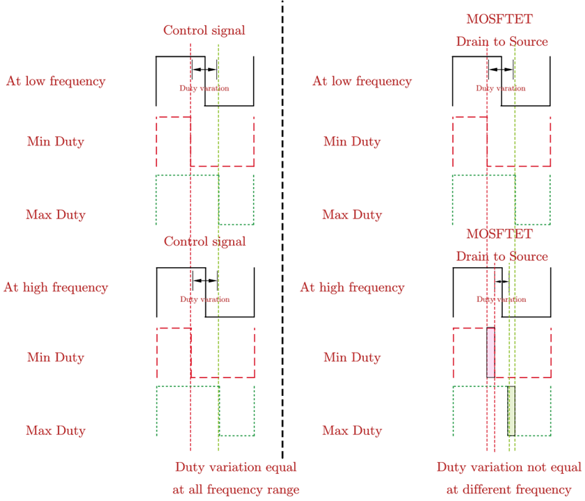

    With converter being stable and in CCM mode, currently I am working on implementing SFRA by TI, to obtain the close loop response of inner current control loop.
    I am using ISETD (Frequency 100 kHz) as control signal with small signal injection in ISETD.
    A new issue has been reported, With sweep the ISETD with small signal injection, I noticed an decreasing in amplitude at MOSFET drain to source.
    I have attached an image for better explaination
    The duty given to the control signal has an equal variation in duty due to small signal injection at the frequency range range specified in SFRA. But, while observing the duty variation in gate to source of MOSFET, I noticed that the duty variation isn't consistent and decreases with increase in small signal frequency.
    I would like to understand whether ISETD is not compactible for implementing SFRA and should I be using ISETA for SFRA implementation.
    Please let me know if the issue asked is not clear.
    Thank you for the replies. It does help.
  • Hi Jeet,
    This may be related to the delay time of converting ISETD to ISETA.  The internal 100k resistor and the ISETA capacitor forms a low pass filter and it may be too slow to respond to your high frequency sweep.
    I would recommend you to ground ISETD and use two RC-RC stage to achieve the PWM to ISETA conversion, in which you can minimize the delay.
