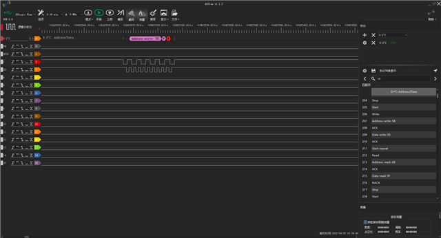

My customer BQ27Z561R1 stuck at ROM mode for unknow reason.
Need your guidance to help me exit from ROM mode.

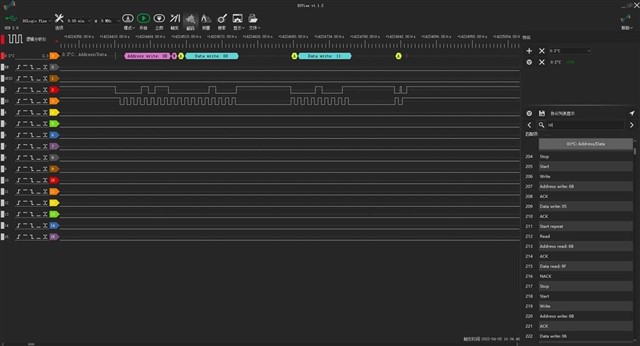

I try to bring it back with below command. BQ27Z561 response ACK correctly with W: 16 08 11 but access to 0xAA(0x55 for 7bit) still NACK after 4s wait.
W: 16 08 11
X: 4000
Pic 1: Response ACK with W: 16 08 11
Pic 2: NACK for 0xAA (0x55)

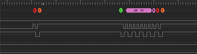

Then I want to reprogram whole flash with dumping *.bq.fs file.
But BQ561 response ACK for 0x16 I2C access but NACK for the all following command like 0x07 register address. You can see pic 3, 4
W: 16 07 DE 83
Below is test.bq.fs I used.
https://e2e.ti.com/cfs-file/__key/communityserver-discussions-components-files/196/test.bq.fs
Pic 3: ACK for 0x16
Pic 4: NACK for 0x7
  • Hello Ryan,
    It looks like some flash may have been erased. Try programming the srec using bqStudui. That should fix it.
