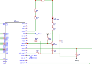

BQ76952: Problem as soon REG1 switched on
Part Number: BQ76952
Please see attached schematic. As soon REG1 is switch on and set to 5V, circuit start drawing > 50 mA. Normally the current should be 1.2mA.
I removed the IC from board and it showing ~ 110 ohm resistance between REG1 pin and VSS pin. I changed the IC and same problem repeated. I also removed the second IC from board and it also showing ~ 100 ohm
resistance between Reg1 and VSS pins
I am using BCX56-16 , NPN transistor. Transistor is not damaged. Please suggest What could be the wrong ?
