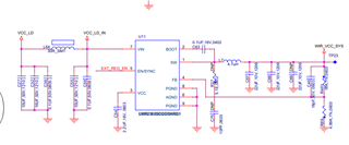

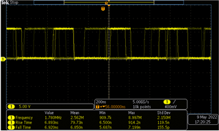

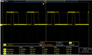

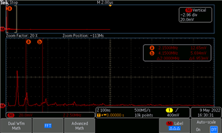

We are using the LMR23625CQDDARQ1 part in our design where the switching frequency is 2.1MHz fixed,
We are using a 4.7uH part for improvement in EMI EMC test and we found the switching frequency is not consistant for 4.7uH part which is trying to shift to left i.e around to 1.6MHz, than it goes back to 2.1mHZ.
Please, let us know the reasomn for this shipment and also let us know how to select the proper inductor part for better performance.
