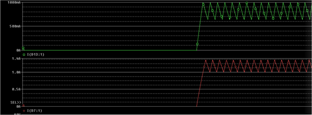

  • Hi Brian,
    Which VIADJ are you changing. The device has two channels and when I change the channel1 VIADJ, I can see that the channel1 current is changing. Please keep in mind that the input to the VIADJ should be an integer number between 0 and 255. When I changed the DAC values of VIADJ1, the current through D13 has changed. Below picture shows the waveforms in both channels.
    Vahid

  • Hi Brian,
    What I meant, is that you would program the constant DC source already connected to the VIADJ pins with an integer number between 0 and 255. For example in picture below that is what I did, and I was able to change the current in D13.
    Vahid
