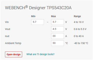

My customer is considering using the TPS543C20A with the three VIN/VOUT cases below.
    CASE 1 : VIN=12V, VOUT=5V
    CASE 2 : VIN=4.5V~5.5V, VOUT=0.85V
    CASE 3 : VIN=5.7V, VOUT=4.5V
When they did the design simulations with TI webench, CASE 3 didn't run on TI webench.
Is there any condition the user must observe between VIN and VOUT of the TPS543C20A?
Is CASE3 not supported with TPS543C20A?
Thank you.

  • Hi JH,
    What switching frequency is being used in Case 3?
    There is a minimum off time of 250ns, at some switching frequencies 5.7Vin and 4.5Vout requires an off time lower than 250ns.
    Britton

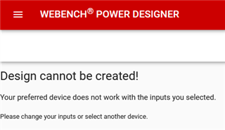

    They didn't input the switching frequency separately as shown below.
    When they click 'Open design' the reference design is not created with the message below.
    Any switching frequency available on the TPS543C20A can be used.
    Is there any way they can use CASE 3?
    JH
  • Hi JH,
    Webench is design tool that is based on equations that try to model the devices, sometimes it has limitation on covering all the use cases. Your case is one of them. As you can see below, i try even to do 6Vin, the tool does not handle it.
    I recommend to use the calculation tool attached
    slurb00 (5).zip
    thanks!
