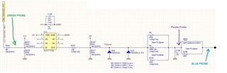

we are using UCC27531 as digital output driver. Input of UCC27531 is driven from MSP430.

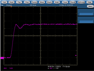

when we put a ferrite bead at the output the signal gets distorted please see the scope shot.
how to proper choose the FB?

  • Hi Kevin,
    the green signal is measured with active probe, and i remeasured the signal after ferrite bead with tip-barrel method and it doesn't remove the signal distortion.
    this signal is digital output , 100Hz with on time 30us. I read your application notes, but i don't understand why would a FB distort a signal?
    How can a Ferrite bead cause noise peaking?
    David.

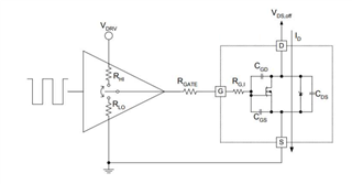

    The small ringing that you are seeing I believe is not from the ferrite bead, but could come from a couple of things on the side of the MOSFET:
    • Parasitic capacitances from Cgs and Cgd  and parasitic inductance creating a RLC resonance which causes an oscillation
    • Parasitic inductances from long trace length and/or poor PCB layout
    You can also take a look at this Tech note that goes into more detail about these effects from the FET
    You can also experiment and remove the ferrite bead and test different resistor values to see if it dampens these effects

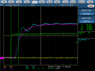

  • Hi Kevin,
    that is the thing i don't have a mosfet after the ferrite bead. please see schematic that i provided previously.
    if you look at my first scope shoot, before ferrite bead ( purple signal is as it should be), and after the ferrite bead i see oscillations ( blue signal).
    This is a push-pull output from a device, and i don't have any load connected to it, only a scope probe.
    Br.
    D.

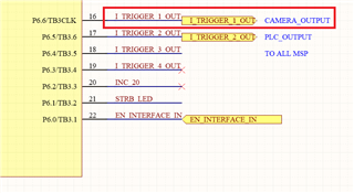

  • Hi Kevin,
    this is the full schematic, the CAM_TRIGGER_OUT signal connects to MSP430 output pin, and after the ferrite bead there is a connector to outside world
    Also we can continue here if you wish, otherwise i will send PM.
    D.

  • Hi Kevin,
    sorry for late replay.
    1) this signal (signal is a trigger signal) is generated on our device ( MSP430 MCU generates this signal) , and it goes out of the device through a  connector.
    The signal connects to a camera via cable to trigger the camera.
    2) The signal shouldn't  have overshoot
    3) i don't think that is a big concern, we will have to test it.
    But what i don't understand if a connect the signal that comes from UCC27531 output to a ferrite bead then i get this noise after the ferrite bead and befor the ferrite bead ther is no noise ?
    Because in this app-note SLUAAI2, the ferrite bead should suppress noise when used with gate drivers and not introduce.
    David.
  • Hi David,
    No worries thank you for getting back to me!
    I believe that the ferrite bead is still doing its job of suppressing noise as indicated by the purple probe protecting the gate driver. It looks like the output of the driver after the ferrite bead is going into a ribbon cable. I assume that the ribbon cable is long in this case. Because of that, there is going to be parasitic inductance introduced. The noise you are seeing is probably coming from the ribbon cable.
    One way to reduce this would be to introduce another ferrite bead at the other end of the cable connection. If the noise still seems to be a concern for you I would try that.
    If you need any further help please let me know!
    Thank you,
    Kevin
