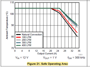

Hello TI Team,
I want to use TPS546C23 Regulator for below requirement.
1.  Vin 12V with 5% tolerance
2. Vout= 0.88V @ 33/34 Amp
3. Ripple Voltage= 20mV
4. Voltage Tolerance= 3% (26.4mV)
5. Load Transient: 50% or less (16.5/17A or less).
6. Ambient Temp.= 85 deg
Can someone please suggest and clarify if I can go with this regulator?
Your quick response in this regard will be highly appreciable.
