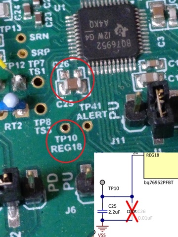

    For another side, checking things on the EVM, I saw something very strange. In fact, loading thes attached file on the EVM, I have 3,3 V on the REG18.
    I don't reach to find where was the failure on this file.       _test3.gg.csv

  • Hi Thierry,
    I don't think it is possible for the REG18 pin to show 3.3V - is there a chance you are measuring a different pin by mistake?
    When I reviewed your settings, I notice that some of the general purpose digital pins are set to drive the REG1 voltage when they are high. Since you have REG1 disabled, I wonder if this could be causing any current draw somehow.
    Matt
  • Hi Matt,
    I found the problem. In fact, you are true, the Alert pin was set for be high when balancing. Also it seems that this pin is latched (using AlarmStatus mask) and so, it stay high despite balancing is stop. The problem was that Alert pn was set with REG18 level instead REG1 level.
     I must take care of this type of feature.
    Regard the 3,3V on REG18, it was not a mistake. I imagine that  any BQ output is set as with REG18 level and connected to host output at 3,3v. So, similar failure.
