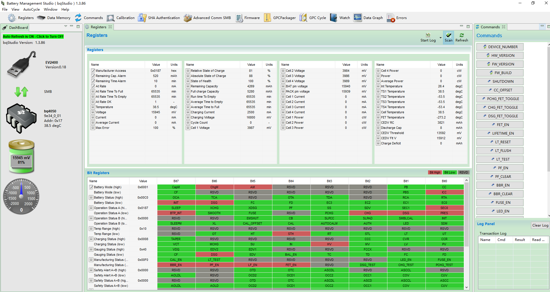

  • SMEN=1,IGNORE_SD=0Hello Keller,
    As shown in the BQStudio screenshot,smoothing is active.If I need to use both "smooth" and "selfdischarge"  , what should I do?

  • Hello Zhao,
    Can you send the link for the thread that was screenshotted?
    From reviewing the code I can see there could be a possible way that the smooth will disable self discharge. Can you share the logs you captured during testing showing the CEDV RC decreasing with smoothing enabled and smooth disabled.

  • Hello Zhao,
    After looking into this more thoroughly it appears the smoothing functionality does not account for self discharge. If you would like to adjust for self discharge the smoothing feature should be disabled. I will correct the other post by Batt to indicate this.
    Essentially with the smoothing enabled we use a different charge accumulation register (all internal registers, not visible) that does not have the self discharge added. When Smoothing is enabled the gauge switches to use the smoothed accumulation value at all times so the self discharge is effectively bypassed (which is why you see the behavior in the logs, when smoothing is activated it is synced to CEDV RC, when smoothing is disabled the SBS RC() switches to the other accumulation registers which does account for self discharge). This was most likely part of the specification of this firmware, it is just not outlined well in the documentation.
