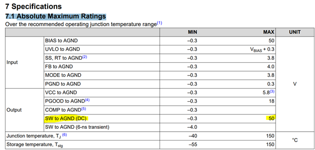

LM5157: Do you know Vds value of internal MOSFET?
Part Number: LM5157
Hi TI team,
I want to know maximum Vds spec of internal MOSFET.
Can you let me know Vds value of internal MOSFET?
Thank you.
Downey Kim.
    Thanks for reaching out. The abs max rating of the switch can be found at page 6 of the datasheet in table '7.1 Absolute Maximum Ratings':
    Please let us know if you need further help.
