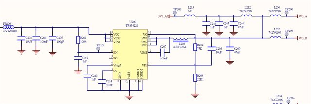

    • Is it possible to share your schematic & BOM for this design that you are testing with? Do you have a custom board built for this?

  • Hello Amod,
    Here is the schematic. Hope this is readable... Let me know.
    This is a custom board initially designed with TPS54226. The input voltage is 12V. The 10pF is already included in the design.

  • Hi Philippe,
    The schematic looks fine as such.
    • Can you possibly decouple the output from the ferrite bead network by removing L202 and checking if ripple across C200 is any different?
    • Please let me know about the output current as I want to check if the device will operate in PFM or PWM.
