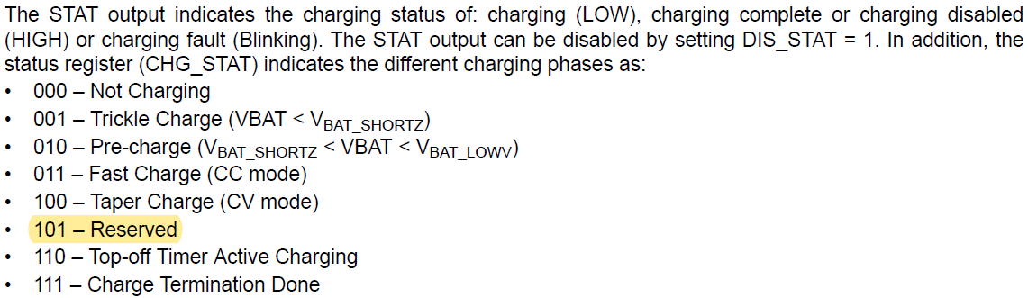

Hi Team,
I would like to know the status register (CHG_STAT).
Is there a situation where " 101 – Reserved" is indicated?
