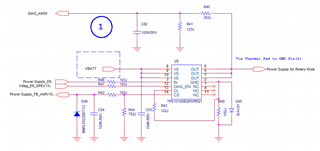

The customer is considering changing version B to A.
Please review whether TPS1H100AQPWPRQ1 can be used for the existing schematic.
** The CS pin(14) is connected to the MCU but is not used.
Hi Cho,
The fault reporting will not be correct. Other than that, it should be no problem.
