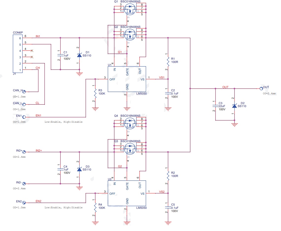

Hi Team,
When IN1=42V, IN2=0V
I measured the quiescent current of IN1 pin to be 4.168mA,
Query the datasheet to know that LVS & LIN & Iout are all uA current levels,
Want to ask where is the quiescent current 4.168mA?
How to measure it?

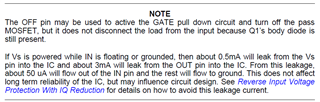

Hi Kevin,
For the LM5050-1 in the IN1 power path, the leakage current would be = IVS + IIN = 100uA + 320uA
For the LM5050-1 in the IN2 power path, the leakage current would be = 3.5mA. The reason for this leakage current is described in detail in datasheet sections - 'NOTE' and '8.2.4 Reverse Input Voltage Protection With IQ Reduction' as shown below.
You can also refer to the e2e FAQ below for more understanding on this topic,
LM5050-1: LM5050-1 Leakage Current
