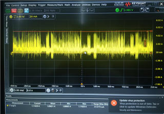

    Yes, The test scope seems not a typical PFM mode waveform, It's more likely the power regulator always switching between from PWM and PFM mode;
    The load current transient we measured will jump from 1A (light load) to 5.5A(peak value) around (heavy load),You can refer to the picture i attached,

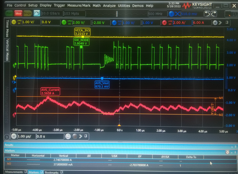

  • Hello, Phil
    Sorry for late reply, As i describled above, We have scope the BUCK SWs node waveform and confirm the PMIC is not in PFM mode and we believe the capacitance screaming is caused by the PMIC BUCK, i will attached the waveform for your reference:
    From your advise "MCU can easily change it to FPWM mode by I2C writing"  but it seems not easy from our side, We have tried to set the FPWM mode when power up the PMIC, But it seems not working, As i understand the PMIC would  upload the NVM value from startup everytime,
    Even we try to change the register value successfully after power up the PMIC, It doesn't come into effect on current cycle, As Michael suggested as below:
    Please advise if you have any comments to add , Thanks!

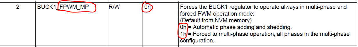

  • Hello Perry,

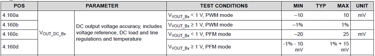

       I just tried again on 3 BUCKs with the EVM I have; they all have proper response for the mode change by I2C writing in current cycle.
       Even without load at all, I can tell by their output voltages: PWM mode has tighter output than PFM mode as showing by table below from datasheet:
      The waveform you captured looks like caused by the "Buck Phase Adding and Shedding" feature since the load change at that moment.
       Please also change the bit below from 0 to 1 to forces the BUCK you test to operate always in multi-phase and forced PWM operation mode:
      Please close the thread if you think your question is answered.
