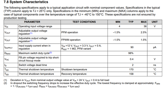

1. If Vin is 8V , what Vout_max of  LMR50410 can be?  It's 7.84V?

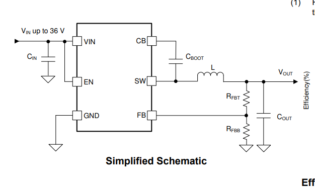

2. What are the Rfbt & Rfbb   parameters under this condition?
