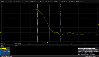

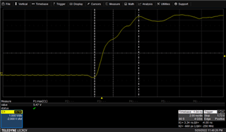

I measured the rise and fall times on a standard EVM for TPS628502EVM-092 with the following conditions:
Vin- 5V, Vout- 1.8V, L- 470 nH, Cout- 2 x 10µF, Iout- 1A
- High side MOSFET rise time
- High side MOSFET fall time
