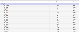

  • Hello Alex,
    Something in your testing is causing the gauge to calculate very odd resistance values, grid points 0 and 2 are 6 and 1 mOhm, which is extremely low. It may be because your cells are very imbalanced that the gauge is not able to get a correct DOD reading for the whole pack, or the chem ID is not correct.

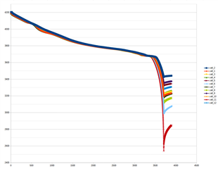

  • The cells are very imbalanced at the end of discharge. But during charging and for the majority of discharge, they are balanced. I never see RUP_DIS being set. The first Ra table flags did change, but the second table flags and values have not changed.

  • Thanks Wyatt. I ran a C/6 discharge today and watched the resistance tables update again. Also, the % remaining is pretty close to accurate. I'm just confused why my full charge capacity is much lower than it should be.
    The red values were updated at the end of discharge. I observed all values 0-14 update at one point in the test.
