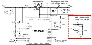

    For faster discharge of the gate-gnd capacitor, you can consider using a pnp based circuit for dvdt control as shown in the image below.

    I think the PNP based circuit will work perfectly.
