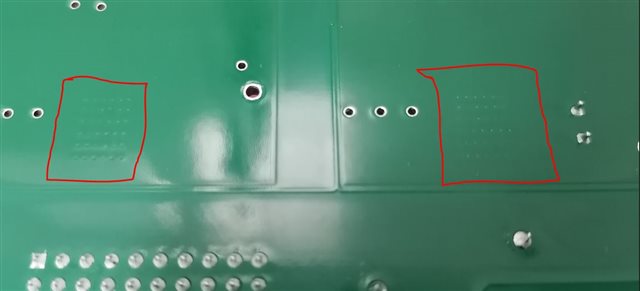

we are using part # IC-LMZ14203HTZ/NOPB in one of our power module product.
after reflow soldering process, we found that part leads has short.
we set all parameters as per part data sheet suggestions but still issue persist.
PCB thermal pad was tented by solder mask at bottom side of PCB. is it cause to solder short?
could you help on this.
Also Could you share your Schematic/Layout? I wanted to see what you ended up doing with the Vias.
Finally, is it possible take a photo of the PCB with out the IC and on the bottom?
same failures was reported earlier and texas done some improvements from their end , could you please update status of those.

Hi Vinoth,
When you removed the parts, are pins 4 and 5 still shorted?
Did both of the IC's (U52 and U53) on that PCB have the issue?
Andrew
It looks like there's quite a few untented/unplugged vias on the top layer.
Could you check if pins 4 and 5 are shorted when the LMZ14203HTZ/NOPBs are unsoldered from the PCB? Also could you please send your layout and schematic?

hi Andrew
find my answers in greens
yes, removed parts had short
yes, both IC's has issue
its fully tented on top layer and part were removed from PCB on those pads so its look like partially tented.
Trails:
1. components are tested prior to reflow soldering process and found that no short on leads
2. after completing reflow soldering process found that leads has shorts (Reflow soldering temperature has been set as per data sheet recommendations)
