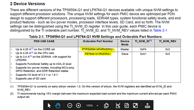

I see in "Powering DRA821 with TPS6594-Q1 and LP8764-Q1" that the device part number is quite old. Could you please advise the latest part number for this design?
Also, I see there is another single TPS6594-Q1 pmic solution for DRA821. Which power solution do you suggest? These reference design is written by your team or someone alse? Thanks.
